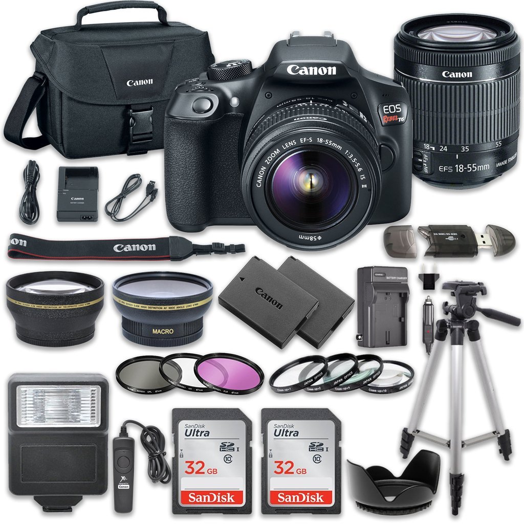

TTMartin
@ryanisthefitz wrote:
I was so enthusiastic to open my new 'full-size' Canon camera after using a small point and shoot for over a decade, only to find that it would not read the flash card that came with the camera bundle on Amazon.  The card is a Sandisk 32gb SDHC Class 10 48mb/s.  I cannot see any reason why this card should be incompatible with this camera.  The error message is that "Card cannot be accessed...." and when I try to format it, I get "Cannot format, change card".  I would most appreciate a pointer or two from someone else who has solved this problem.
Is this the 'Bundle' you purchased?
Unauthorized Reseller

That's not the exact one but it is close.  Thank you for the reply.  The exact one I can't find right now as it was a birthday present.
