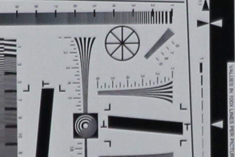

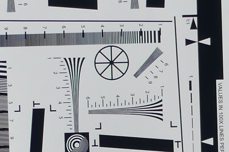

well i tried everything I know how to do, after a reset now all the photos are equally blurry no matter what mode or setting is used, i guess that is some progress. the Lumix puts this camera to shame !!
01-14-2019 02:50 PM
Did it just start? Any other lens to try?
01-14-2019 03:07 PM
Sharpening is certainly applied to JPEGS, at what magnification does this blurriness appear?
01-14-2019 05:41 PM - edited 01-29-2019 10:31 PM
all 3 taken at 75 feet, the first one is the gold standard (in my eye) the Lumix hand held at full zoom (750mm) 20 such shots came out like this, second one is the 70-300 (300mm) on tripod (best one) and the third is the short 28-135 (135) on tripod, best one.
