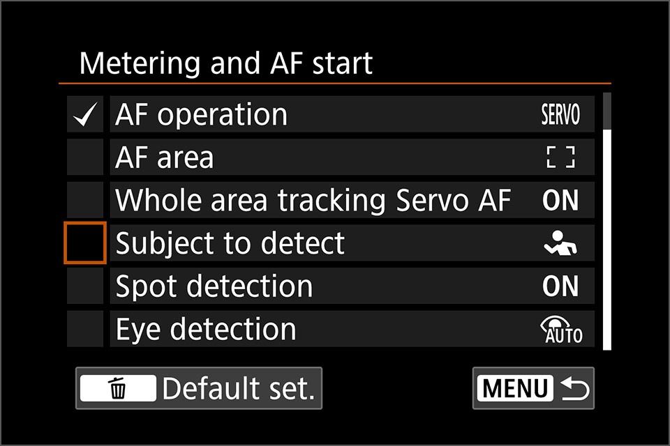

1. Turn off Whole Area tracking servo AF
This will stop the camera tracking when the AF area is set to anything other than whole area AF. Yet whole area AF will still track. If you set the subject to people then it will track faces and with eye detection it will track eyes. It is possible that the camera will still sometimes take a point slightly outside of where the AF point is positioned if it finds a face.

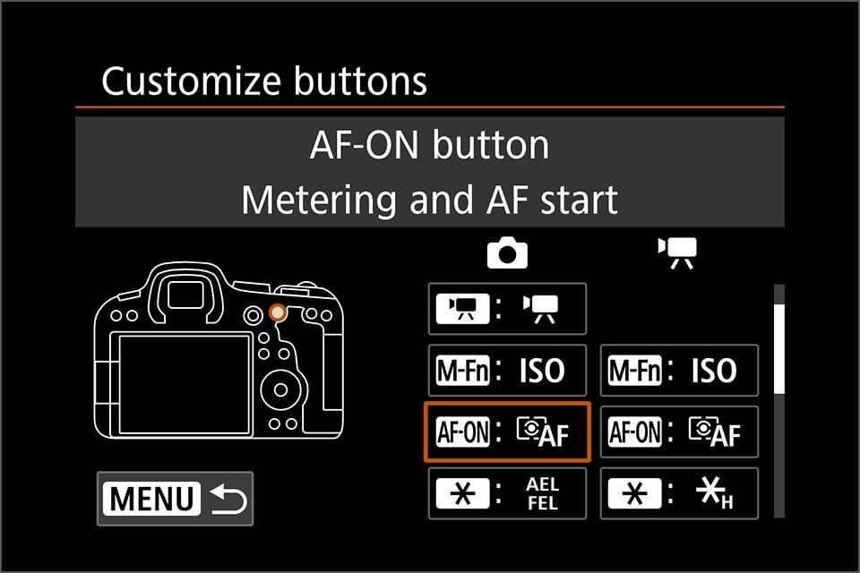

3. If you use back button AF, you can set different options with each of AF-ON and "asterisk" button.
Both AF-ON and the asterisk button can be configured with different settings, but you need to access the deeper levels that are not covered in the manuals. See below for an example. You could have the AF-ON set for face tracking with the whole area, and the asterisk configured for 1-point AF and no whole area tracking.
 Here's a couple of screen grabs from my EOS R6 Mk2 to show you the way. On the second screen you press INFO to get to the third one.
