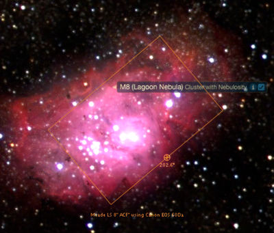

Your scope has a focal length of roughly 2000mm. (it's probably 2030mm). If you attach a Canon DSLR with an APS-C size sensor to that scope, the angular width of the area of sky that you can see is 38' x 25' (that's in arc-minutes). In other words it's just slightly more than 1/2º wide in one direction and a little less than a 1/2º tall in the other direction.) This is not a big piece of sky.
Here's a simulated (using Starry Night Pro Plus 7) image to show you how, say, the Trifid nebula would fit in the frame if taken with your scope & camera combination (I just picked any 8" Meade f/10 scope to let the software calculate the correct frame dimensions. The orange box represents the size of sky that will fit in the image.
So that works... but the problem is different things in the sky require different sizes... if you point the scope to, say, the Lagoon nebula (which is right next to the Trifid nebula -- just below it in the sky), this is what happens:
You can see this doesn't fit. You'd need to take lots of images and then piece them together as a mosaic (which software can do). OR... you can use a focal reducer. Here's the image with a .62x focal reducer:
This increases the area of sky that will fit in the frame:
You can see that now the frame size is expanded so that it mostly fits (ok, it's a tight fit - but most of it does fit in there.)
That's the point of hte focal reducer... it allows you to capture a larger area of the sky by reducing the focal length of the scope. it is, in effect, the opposite of a tele-converter because it's a focal length reducer rather than a focal length extender.

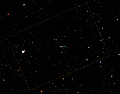

But you're trying to image Saturn... so let's look at that:
And there you go! That's a simulation of Saturn, as imaged through a simulated scope with the same focal length and properties as yours and using a camera with the same properties as yours... but with a focal reducer.
Do you even see Saturn? It's there... but you wont like this image.
Here it is again, but without the focal reducer (native resolution)
This helps, but not enough...
What's going on?
Saturn doesn't occupy a very large area of the sky. It's only 18" (arc-seconds). Remember I mentioned earlier that the sensor can image an area of the sky which was 38' (arc-minutes) x 25' (arc-minutes)? Well Saturn is so small in the sky that it isn't even 1 arc-minute... it's size is measured in arc-seconds (60 arc-seconds = 1 arc-minute and 60 arc-minutes = 1 degree).
