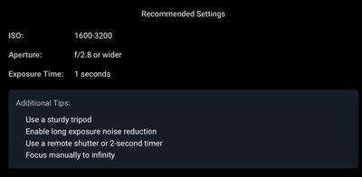

https://focusonlens.com/calc/calculators/astro.php
This is the formula that should be used with modern digital cameras.
Have you processed the images you posted; what software did you use to render the RAW files?
07-30-2025 04:24 PM - edited 07-30-2025 04:37 PM
“ https://focusonlens.com/calc/calculators/astro.php
Have you processed the images you posted; what software did you use to render the RAW files? “
Thanks, for the interesting link, John.
I neglected to mention that the formula I posted assumes ISO 100. John’s link seems like it would give better results.
I entered focal length and aperture. The tool calculated ISO and shutter speed.
If you divide ISO by 16 and multiply SS by 16, then you get the same result as the formula. The formula reports the longest exposure time, not necessarily the best exposure.
What I like most about John’s link is the shorter SS. You can capture several and stack them. Just keep the total length of the series of stacked exposures under the maximum time provided by the formula, 26 seconds.
