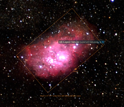

So that works... but the problem is different things in the sky require different sizes... if you point the scope to, say, the Lagoon nebula (which is right next to the Trifid nebula -- just below it in the sky), this is what happens:
You can see this doesn't fit.  You'd need to take lots of images and then piece them together as a mosaic (which software can do).  OR... you can use a focal reducer.  Here's the image with a .62x focal reducer:

You can see that now the frame size is expanded so that it mostly fits (ok, it's a tight fit - but most of it does fit in there.)
That's the point of hte focal reducer... it allows you to capture a larger area of the sky by reducing the focal length of the scope.  it is, in effect, the opposite of a tele-converter because it's a focal length reducer rather than a focal length extender.
