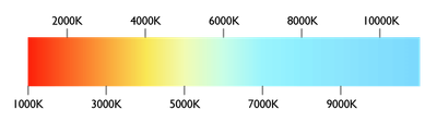

in regards to your first question, The color temperature (Kelvin) you select depends on your preference.  5600k is the industry standard for outdoor natural light.  Going lower will increase the intensity of reds and yellows. Going higher will increase the intensity of blue or cooler shades.  5600k is a safe starting point that allows you to go in either direction.
