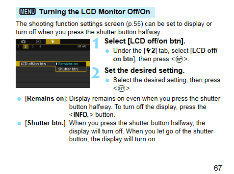

You may also go to the shooting function settings screen to set the function :capture-20180522-194355.png
Thanks, I saw this but this is not the same as automatically turning off the lcd when you look through the viewfinder.
80D doesn't have the feature. So you have to do it manually.
