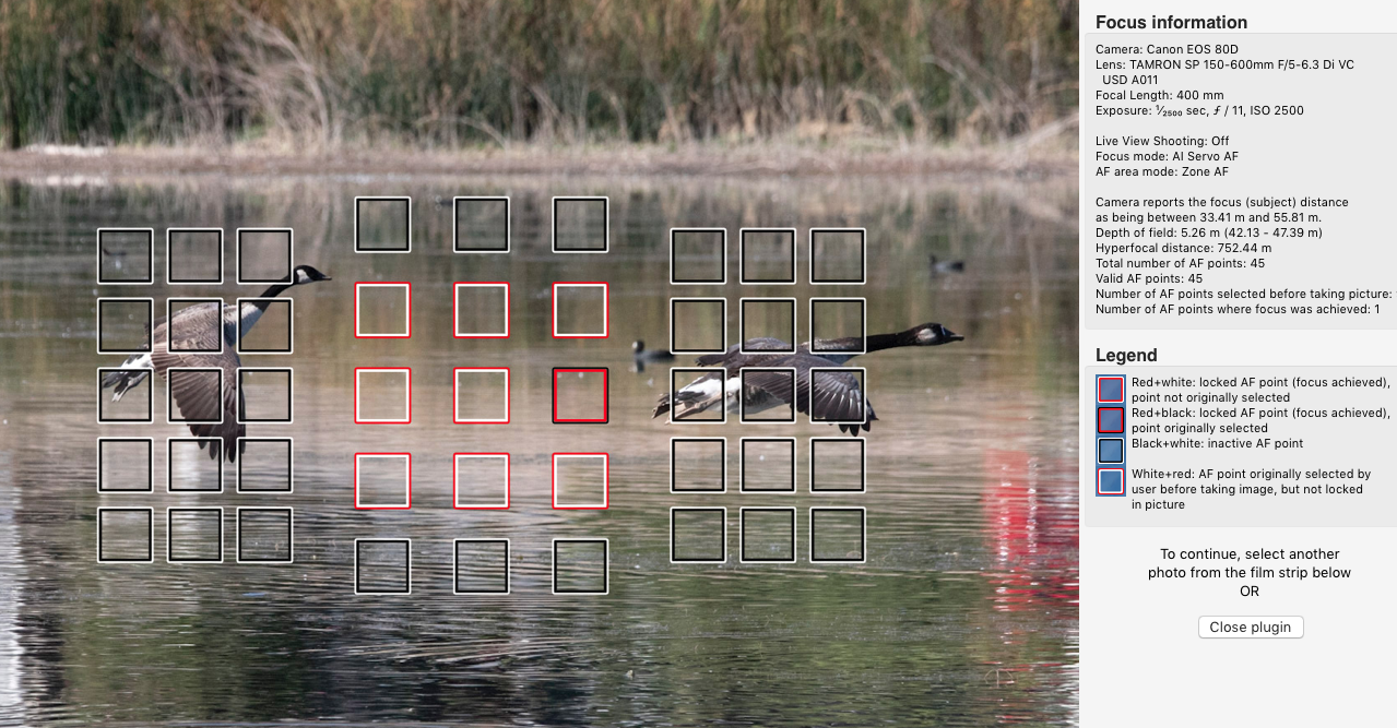

When shooting BIF sometimes bird is in focus other times not. When using single point or zone 9 focus points I will check where focus points locked in they show locked on bird/birds and shot is not in focus, or when shows focus points locked on background and not on bird/birds they are in focus as in image below any ideas why?

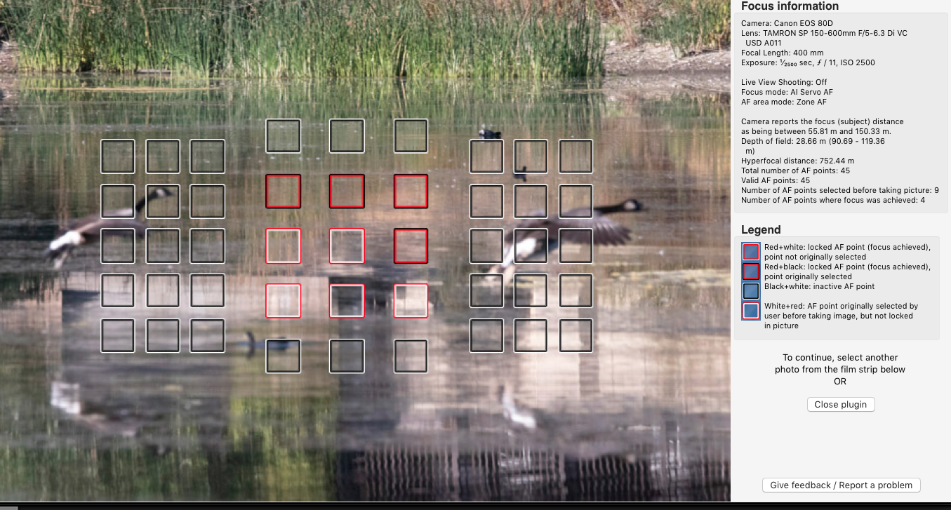

same sequence two frames later, so within a second or so, why is this one not in focus, the frame right before was in focus with out focus points on bird, what am I not grasping

@chief54 wrote:same sequence two frames later, so within a second or so, why is this one not in focus, the frame right before was in focus with out focus points on bird, what am I not grasping
You are simply not locked onto the subject. The AF points seem to have lost the BIF, and locked onto the background.

Waddizzle, I appreciate advice, but once again 1st image of geese is not locked on bird, yet it is in focus, why? I understand the image with 4 focus points is not locked on bird but on the background so bird is not in focus, I get that but previous image has focus point not locked on geese but they are in focus, niether image has focus points locked on geese yet one is in focus the other is not. That is why I am not getting this. why one is in focus and other is not

@chief54 wrote:Waddizzle, I appreciate advice, but once again 1st image of geese is not locked on bird, yet it is in focus, why? I understand the image with 4 focus points is not locked on bird but on the background so bird is not in focus, I get that but previous image has focus point not locked on geese but they are in focus, niether image has focus points locked on geese yet one is in focus the other is not. That is why I am not getting this. why one is in focus and other is not
First, it is not possible for us to judge focus from a screen shot. If you say it is in focus, then I will take your word for it. The Birds are in focus because they could be within the DOF of the AF points that locked focus.
Second, you there is a time delay between the AF points lock focus, and when the shutter fired. This delay is longer when you are using One Shot focusing. Your subjects are constantly moving, your camera could be moving, so the captured image can be misleading. What is important is that it locked focus on something, compared to not locking focus on something.

"...why this photo is in focus when none of focus points are locked on birds,..."
Two things time lag and incorrect panning.
