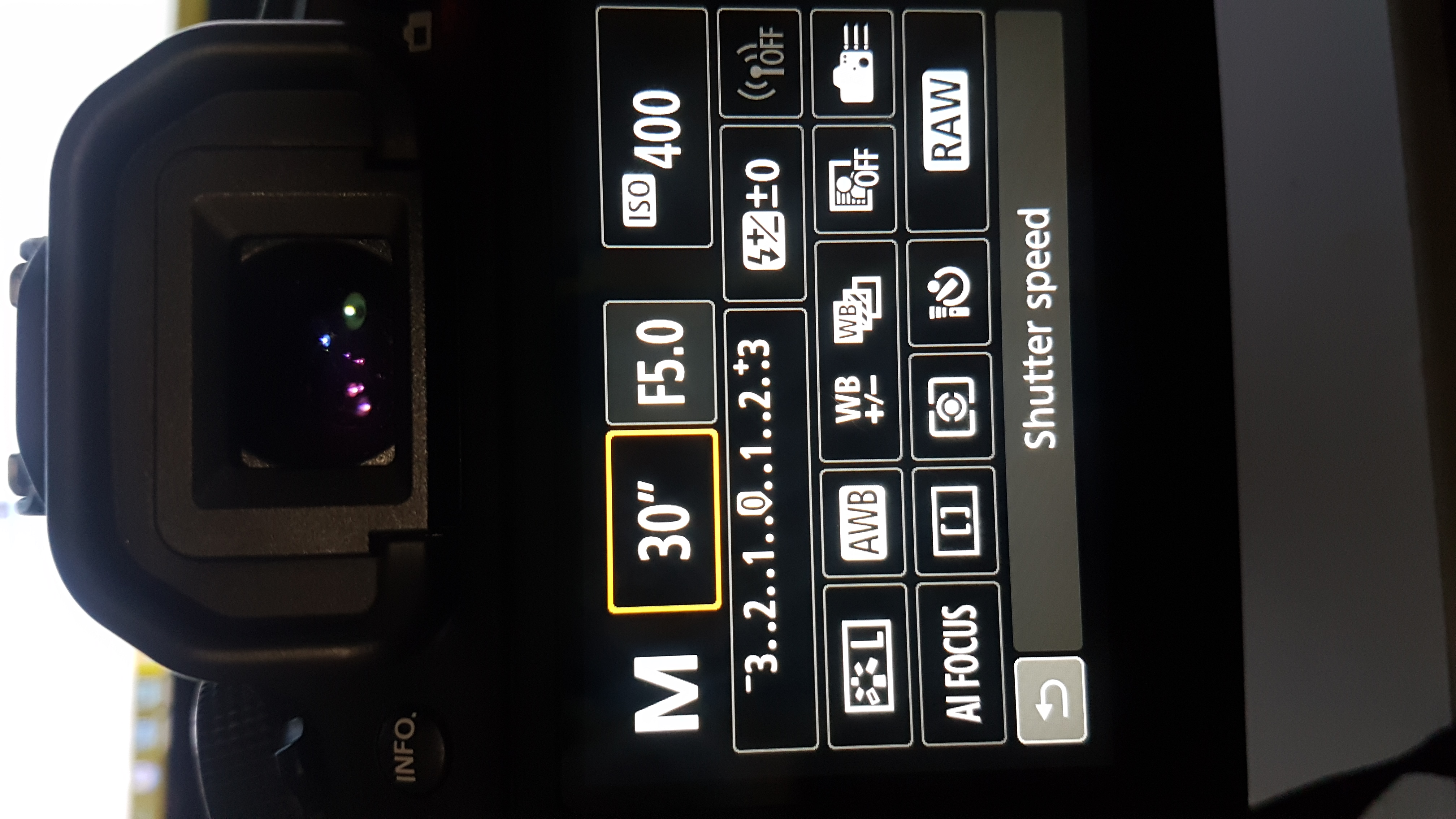

For some unknown reason i can't get past 30 seconds into bulb mode

Deevo78
It can be done
On cameras without a bulb mode, you are correct. But on the 80D you have to set the mode dial.
Even on my entry-level T6,which doesn't even have a 'B' selection on the mode dial, using the Bulb function to keep the shutter open is a simple process. Download and read your manual.
I read the manual. It is actually a little unclear. It does not even have a separate B Mode section when it describes the advanced modes:
Not sure what manual you're looking at. Bulb function is clearly described on page 204 of the 80D instruction manual (PDF). Seems simple to me.
EDIT: Also look at pages 205-206.
Bit by Canon again! I was referring to the BIM, not the IM.
