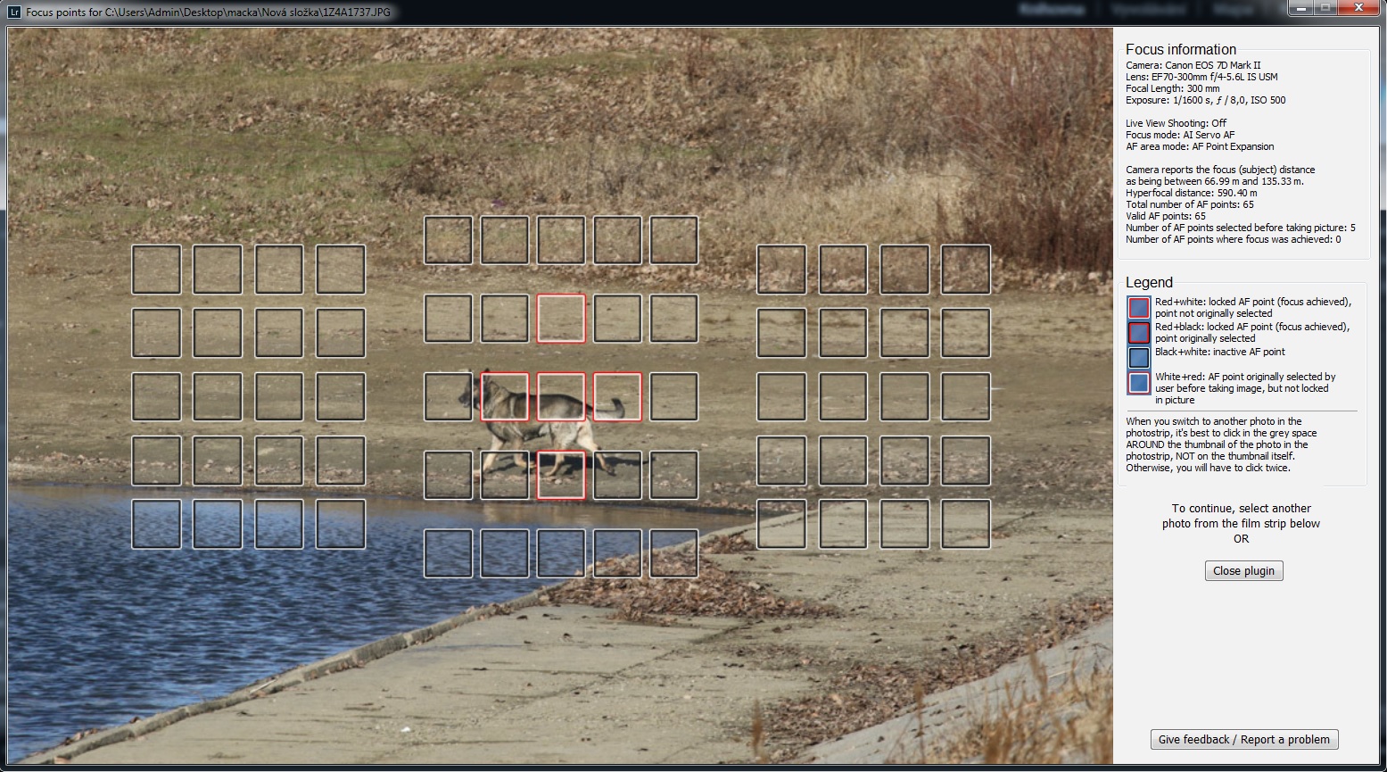

The AF points displays and focus information show that your AF point was selected, but not locked when the picture was taken. Note the color of the AF points.
It also reports that you're using AI Servo Mode, and that ZERO AF points have achieved focus. Try using One Shot mode, to test for sharpness. For some undetermined reason, you're not tracking subjects very well..
