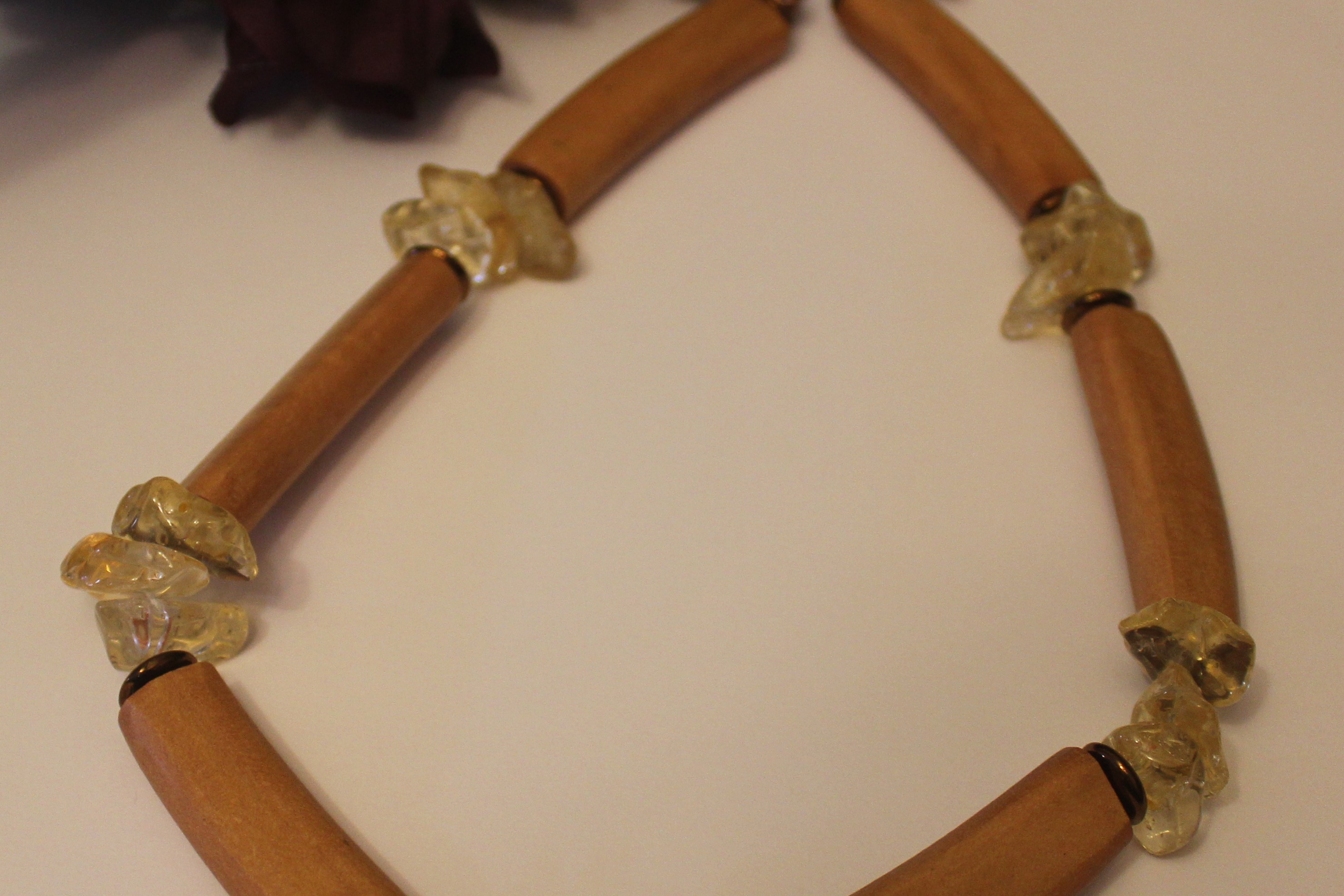

Before I go crazy can someone please please help me. I have tried it all.
I design jewelry and take photos so I can post online. For some reason, I cannot get the photo to be clear. Some of it is clear but then part of it is blurry. I have no idea what I am doing wrong. It's not the lighting as I have a light tent plus I have tried outside etc. I really think it's the settings that I cannot figure out.
I will say that when I first got the camera I could take some that were very clear. Then I started playing with the settings per YouTube instructions and that is when I lost my ability to take good clear photos.
Please help!!!

I read some info that you suggested. I am not taking photos up that close. I design jewerly and need to take photos of my creations to put online. This is only some of the photo as it is too big to post. But see how some is clear and some of the photo is blurred? That is what I am trying to figure out. I am not talking about micro marco photos, just photos of necklaces. Thanks

@mamassey40 wrote:I read some info that you suggested. I am not taking photos up that close. I design jewerly and need to take photos of my creations to put online. This is only some of the photo as it is too big to post. But see how some is clear and some of the photo is blurred? That is what I am trying to figure out. I am not talking about micro marco photos, just photos of necklaces. Thanks
Waddizzle urged you to read up on "depth of field", so I'll assume that you did that. In that picture, the difference between the distance from the camera to the lower part of the necklace and the distance from the camera to the upper part of the necklace exceeds the depth of field of that lens at that aperture. That's why the upper part of the picture isn't in focus. If you want the whole picture to be in focus, you will have to position the necklace and the camera so as to correct that situation. Use of the word "macro" (or "micro") in the description of your problem or its solution is entirely optional.
Bob, is correct about the DOF, depth of field, working against you. Your shot is excellent. The laws of physics are working against you, making it almost impossible to get the entire jewelry piece in focus. This is due in large part to the proximity of the lens to the subject.

Try backing off, which increases the apparent DOF, so that you can crop the photo in post-production and processing to the size you want.
A costly tilt-shift lens could probably capture the entire piece in focus in one shot. But, if your best path to getting the entire piece in focus in one image is either, back off the piece and crop the image, image stacking [which photoshop can do], or a T-S lens.
Or, try to reduce the angle at which you shoot the piece. Try to shoot looking straight down at it. This shot is still shooting at angle, but I wound up raising the tripod, and shooting nearly straight down.

Another very simple approach might be to take a series of shots with increasing f stops. As your numerical f stop goes up, the size of the aperture opening goes down. Wide open, you will get a very narrow depth of field; while smaller openings yield greater depths of field. This is very basic, and should have been explained in the reading that has already been suggested.
Try it for yourself and see what happens. At least part of your solution may be as easy as using the appropriate aperture for your subject. This, plus other tips already discussed, should help you greatly.

@mamassey40 wrote:
What do you mean by "If you want the whole picture to be in focus, you will have to position the necklace and the camera so as to correct that situation"?
I am sorry, so new to this. I am not looking to be a professional at this, just want to make a good photo of my jewelry to post online.
I think Bob means to not shoot at an off angle, relative to the necklace. Try to shoot straight at the jewelry piece. I can adjust my tripod in the above phtos to shoot straight down, which is how I photographed the posted shoot of the plate of food.
When you shoot at angle, consider the distance to the lens of the nearest part of the necklace. Then, consider the distance to the farthest part of the neclace. You need to shoot with a Depth-Of-Field that covers that entire distance, which is hard to do when you are very close to the necklace.
What you can do is back away a little bit, if you want to shoot at an angle. Or, you can shoot straight at the piece, so that nearly every part of the necklace is the same distance from the lens. Again, the second scenario is how I photographed the plate of food, because I faced the same problem as you. I could not get the entire plate in focus, front to back.
