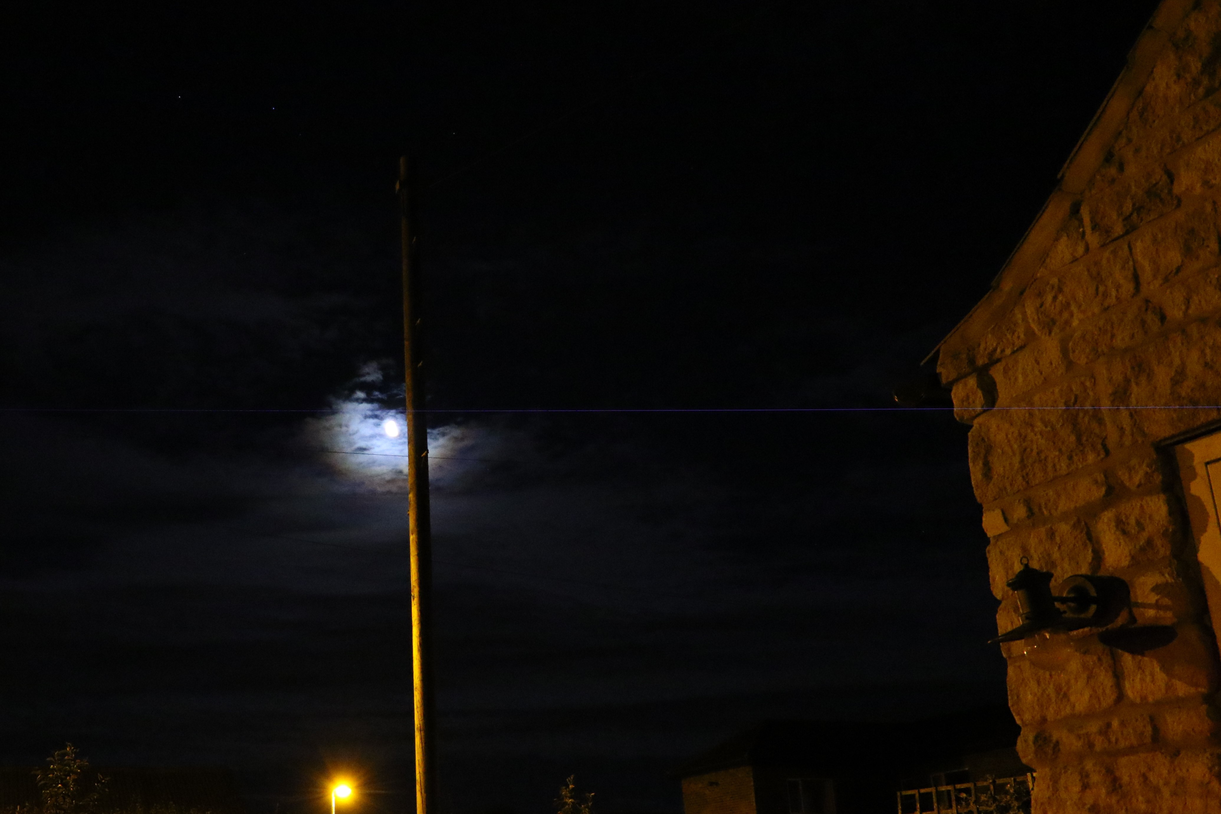

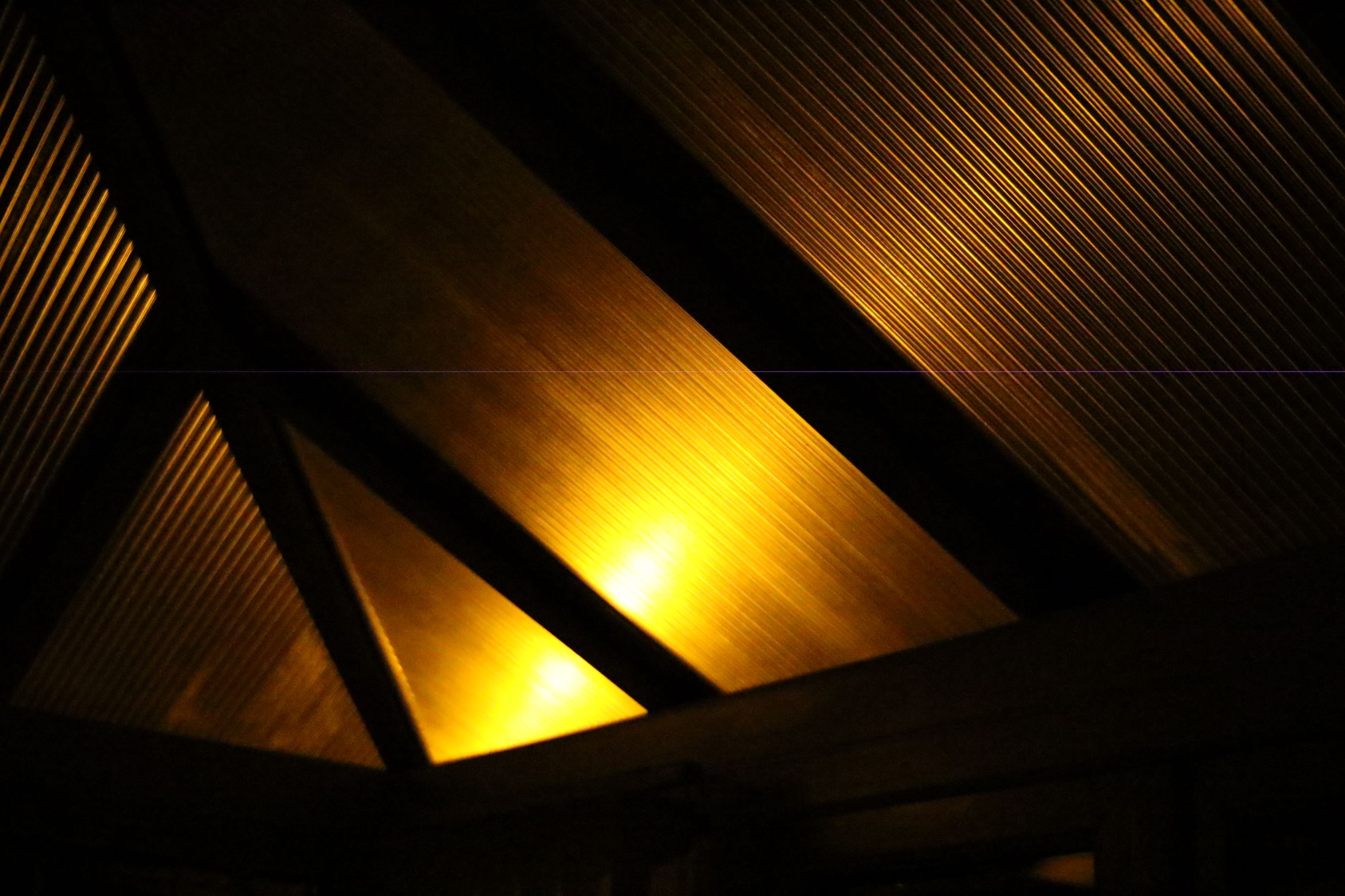

So just over a year ago I purchased by first Canon DSLR, brand new, and am enjoying using it. However the past couple weeks i've noticed, especially in darker areas or higher ISOs, that the camera would produce a very clear, sharp, perfectly horizontal line across my image, about halfway up, halfway across from the right. I hope you guys can see it from the uploaded images, right clicking to open into a new tab makes it a lot easier to see.
Has anyone ever experienced this before? I'm really fearing the worst - sensor issue. Especially as I'm out of warranty now. I've tried a new SD card, re-flashing firmware, factory reset, and different lenses (Sigma F1.4 and my Canon USM 18-135mm) The line appears even if there is no card installed (when you quickly preview the image), but does not appear at ISO below 800, nor is it visible in live view mode while zoomed in digitally, or in a video recording! I'm very confused.
Is there anything else I could try?

Just by eye... it looks like two of the images might show the same row of pixels... but the other image looks like it’s almost directly in the center.  Did you crop any of these (is it always the same row or is it a random row)?

Campbell yes sorry i should have mentioned that in the original post, the second image of the moon/sky is indeed cropped, I did this to make it easier to see the line. When viewing a full-size original image, the line is always exactly in the same spot. Sometimes it's black, sometimes white/yellow/blue etc, but its characteristic is identical across all photos.
