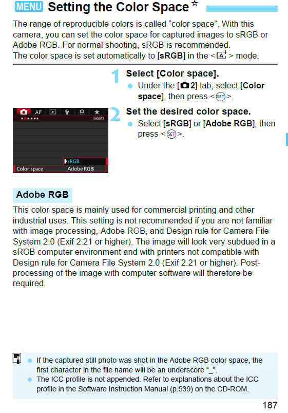

06-05-2016 09:34 AM
Note the info in the blue box at the bottom.
06-05-2016 09:38 AM
Changing the Colorspace to RGB worked. I read through the instructions on how to rename the file and there wasn't anything about the Colorspace setting.
