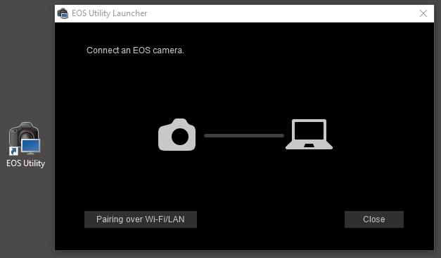

It appears you think I am stupid. I can assure you that I am not. I did uninstall ALL Canon programs and then re-installed EOS Utility 3. I re-booted my PC and the EOS Utility 3 was on my toolbar - so I quit the program and then double clicked the icon to run EOS Utility 3. I connected the Canon EOS 7D Mark II and powered it on. So I did run it manually and it does not detect my Canon 7D Mark II. It does seem this is not going to be solved here, so thank you for your patience. Here are the screen shots.
#1: Turning OFF the EOS Utility 3 program.
#2: EOS Utility 3 NOT detecting my powered ON Canon EOS 7D Mark II camera and the Icon of EOS Utilty 3.

You will simply not believe how simple the answer is...................
‘’Remove the WiFi card prior to attaching the camera cable which connects to the camera & Computer.”
re attach the camera to computer via canon cable.
‘’It will now work
