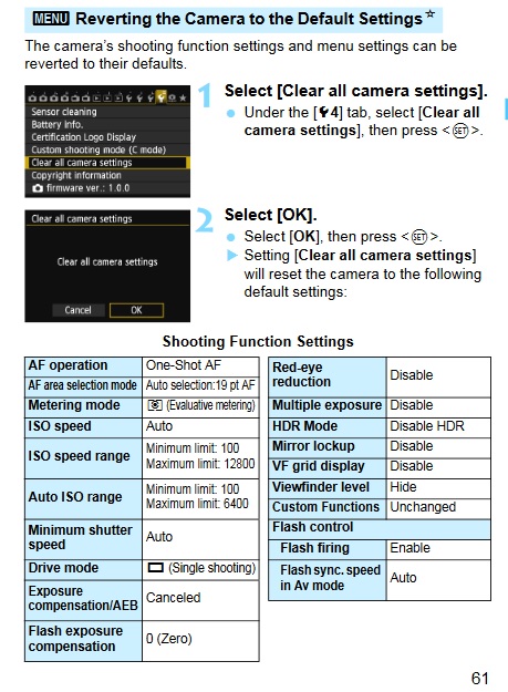

Try resetting the camera back to its' factory defaults.
03-05-2021 01:19 PM
How do I do that?
03-05-2021 02:05 PM
The * indicates that you have to be in one of the modes like P or M.
03-06-2021 11:00 AM
You'd think it would be that easy, but I don't have any of those functions under "Battery Info." I just have those top two.
03-06-2021 11:01 AM
Look at my post. You have to be in P mode to see all the options.
03-06-2021 11:10 AM
Unfortunately, that still didn't solve the problem. The wifi function is "enabled," but the wifi is still off. I'm worried at this point that it might be an issue with the wifi chip itself. Thank you for your help.
