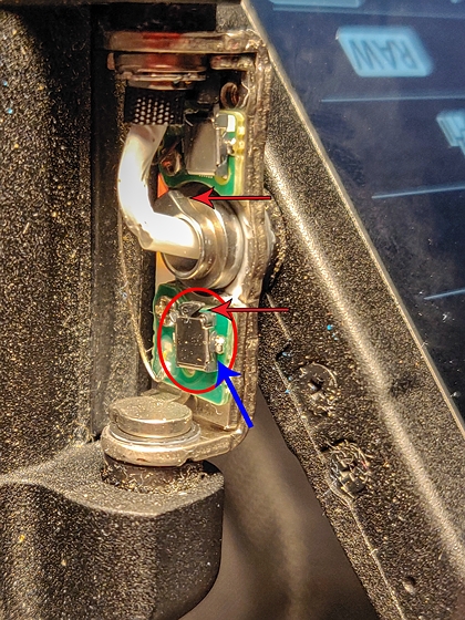

@Stuwe3000 wrote:
Wondering if someone could help me I’m having an issue where the image is mirrored when using live view when the flip screen is in the normal position but if I record footage and play it back in camera it corrects the orientation. Hoping someone has had this issue before.
Are you taking a "selfie" when this happens? It may be that it's set up to show you the scene as though through a mirror, on the theory that it might be less confusing. Otherwise, it's likely that the flip screen has (or the camera thinks it has) been twisted into an unrecognized configuration. I'd call Canon Service; they may be able to walk you through some possible "unwinds".

It is a hardware issue not a software issue.

On the top right camera settings turn off mirror live view
