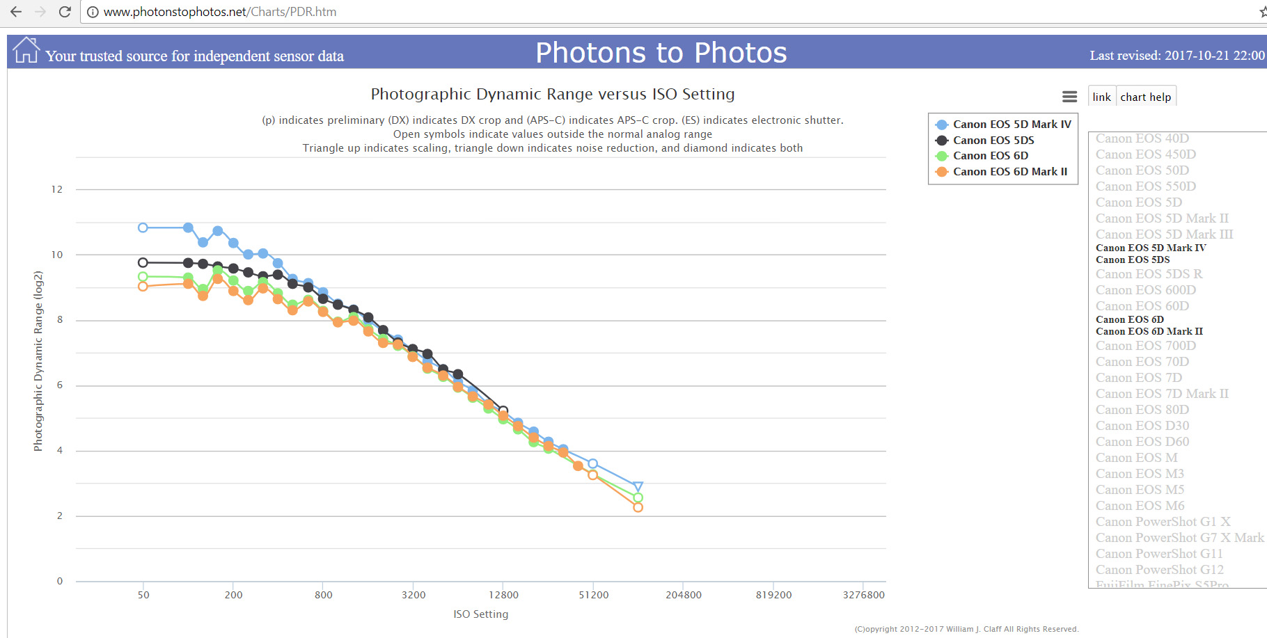

@Waddizzle wrote:The 5Ds has better dynamic range than the 6D2 and the 5D4? What on Earth are you talking about?
The 5Ds has a base ISO range of 100-6400, while the 6D2 has a base ISO range of 100-40000. While 5Ds has twice the resolution of the 6D2, the 6D2 blows the socks off of the 5Ds when it comes to low noise. The 5D4 has a base ISO range of 100 to 32000.
@Waddizzle - Why don't you read what I actually wrote before you hit the "post" button?
I never said the 5DS has better dynamic range than the 5D Mark IV. Seriously, reread my post and then quote where I say that.
In fact, I said the opposite! Jeez!
Second, yes, the 5DS does have better dynamic range than the 6D2 at all ISOs (that the 5DS delivers). Why exactly are you mentioning ISO ranges? Are you telling me that you think dynamic range is the same as ISO range??? If that is the case, then I would also recommend that you familiarize yourself with the different concepts before you start ranting again... The ISO range of a camera does not have anything to do with the dynamic range of a camera as the graph below shows... I.E. The 5DS has a shorter ISO range than the 6D2, and yet it also has better dynamic range over the 6D2 (you are welcome!)
Okay. I see, you’re just comparing dynamic range across the ISO range the 5DS delivers, which is apples to oranges.
So, the 5Ds is better at going from 0 to 30 mph, but only has a top speed of 35 mph, while the others have top speeds over 60 mph. Again, that’s apples to oranges.
But, if the 5D4 has better dynamic range than the 5Ds, across the ISOs the 5Ds delivers, then what good is a 5Ds? I’m just trying to make sense out of your facts and claims, which seem cherry picked to me.
LOL...
OK, honestly, I don't care if you agree with me or not... If you are a happy human being then I am good...
Yes, you are right, I am comparing dynamic range across the ISO range of the 5DS. But that is so that I can compare apples to apples. The 5DS maxes out at 12,800. And until that point it has better dynamic range than the 6DII. And after that you cannot compare them because then that would be comparing apples to oranges.
It sounds like to you, a camera with ISO 20,000,000 would be a dream come true. In your analogy, that would be like a car that can do 1,000 mph, but your analogy is completely wrong. A better analogy is that ISO 50 is Formula One, and ISO 12,000 is little kids racing in tricicles, and that is as far as the 5DS goes. And the 6DII goes even further and you can play races with tinny little plastic cars... If that is what interests you, then good for you. Personally, I don't see the point, but that does not mean that I am right. Is it a good thing that the 6DII has a wider ISO range? Yes, it undoubtedly is, but that does not make its poor dynamic range at the more important end of the ISO range any better.
And on to your last point, yes the 5DIV has better dynamic range. But dynamic range is not the only important thing in a camera, right? I mean, I still have a Canon system, and Canon does have the worst dynamic range ever! I think the 5DIV is a better all-around camera, but I make very large prints of my work, so the 50 MPs are more important to me than the superior dynamic range of the 5DIV. However, I do need a third body with good dynamic range and since Canon is not going to provide it, I am going to get a Pentax K-1, which does not have a very good focusing system and the Pentax lenses are not as great as Canon's, but it will have to do... Because life is not perfect. Happy shooting!
