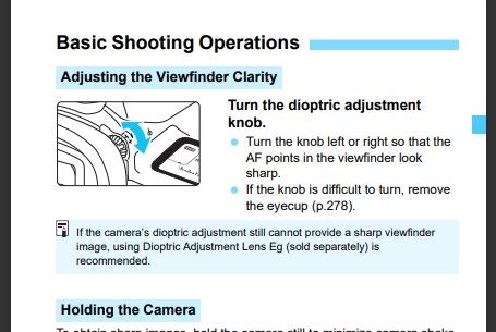

Try adjusting the diopter. It's the very small wheel control along the outside upper-right corner of the viewfinder.
08-28-2023 07:02 PM
"Any thoughts? " Yes - download and read the manual.
EOS 5D Mark IV (WG) Instruction Manual (sg.canon)
