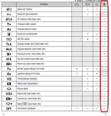

The Control Ring on the lens can be programmed to the following functions on the R5.
Set AF<Control>MF switch on the lens to Control
See C.Fn3 for dial programming options
Canon : Product Manual : EOS R5 : Custom Function Setting Items (start.canon)
Hope this helps 😀

That's all there is to it?  So it doesn't matter how you program the button.
Why don't they publish a user guide for this?
