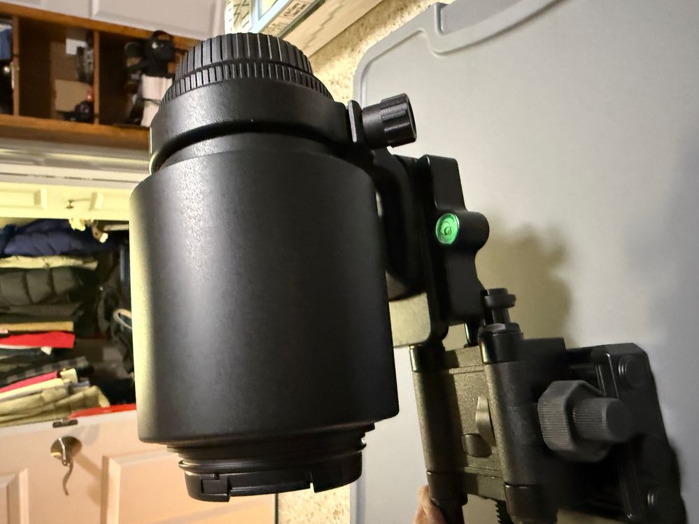

Thank you for the pictures, to be honest I thought the lens was much bigger than it seems in your pictures. Please forgive my stupidity, but how is it that you turn the lens to go the way you want on the Oben? I am guessing there is a particular Arca plate for that or does that unit twist to turn forward? I am guessing it twists by the positions of the bubble in each photo being different?  Sorry, I have never even seen macro done so I am pretty ignorant when it comes to this kind of photography. (And most if I am to be honest with myself)

Hi Far-Out-Dude,
Hoping you get well soon and resume your normal activities.  Since Rick (shadowsports) mentioned that I could answer your questions regarding the RF100mm f2.8 L Macro IS USM lens on an R5 Mark II, here are my 2 pence.  Regarding your questions about mounting it to a Gimbal and or a rail.
Q1: "Can I use the Canon Tripod ring mount with the gimbal or not?"  A1: Yes, you can use a Canon tripod ring with a gimbal head.  The tripod ring itself isn't directly compatible with most gimbals so you'll most likely need to attach an Arca-Swiss style plate.  The advantages is using the tripod with a gimble are: Smooth tracking, Reduced strain on  the camera mount compared to body-only tripod mounting.  Balancing may be trickier since the RF100mm macro lens is lighter and the ring sits close to the body. Using the tripod ring with a gimbal will give you both precision balance and fluid movement for fast moving subjects.
Q2: Yes, the Oben 7" Macro Focusing Rail (FRM-7L) will work very well for precision macro photography; it is sturdy, smooth, and designed for fine adjustments at high magnifications and it has a load capacity up to 22 lbs which is more than enough for your R5 Mark II and RF100mm L Macro set up, even with a flash bracket or heavier body.
Although I have a Gimbal, for Macro photography, I use a "Ball Head" (Ball Swivel Head) because it is generally better than a Gimbal Head for Macro photography.  Gimbals excel with heavy telephoto lenses for wildlife or sports, while ball heads provide the fine positioning and stability needed for close-up, high-magnification Macro photography work.  Gimbals are designed for fluid tracking not micro adjustments.
Why Ball Heads win for macro photography:  Macro requires precise framing and focus stacking.  Ball heads will  let you lock your R5 Mark II at exact angles.
  • Compactness: Macro setups like your Canon RF100mm Macro benefit from a lightweight head that doesn't ad bulk.
  • Stability: Ball heads hold lighter macro lenses firmly without drift, specially when paired with a focusing rail.
  • Versatility: you can quickly switch between macro, portrait and landscape orientation for different compositions.
My Macro equipment consists of an R5 Mark II and R6 Mark II cameras, an RF100mm F2.8 L Macro IS USM lens, Kenko tubes, Godox MF-R76, carbon fiber Sirui 3 foot quick release monopod, a Manfrotto carbon fiber tripod, and a Sirui Macro Focusing Rail.  I also have a Sirui Carbon Fiber Gimbal that I do not use for macro photography and use it primarily for wildlife and sport photography.  Also, although I own a focusing rail, I very seldom use it as most of my shots are handheld, and I only use the focusing rail with a tripod.  When shooting macro one needs to be able to get close to the subject fast enough before it moves away and for that you can't have bulky equipment that will impede you from getting into small places, therefore keeping it simple works for me.  I to date have hardly used the focusing rail.  If you're going to be taking pictures of coins, jewelry, food, and subjects that stay in place, than the focusing rail will come in handy.  As you can find plenty of fascinating subjects at home, like fruits and vegetables, fabrics and cloths, water or bubbles, paper and books, coins and currency, stones and shells, feathers, spices and seeds, ice crystals, flowers and leaves etc.  The key is to look for textures, patterns and subjects with tiny details that would normally go unnoticed and that provide abstract compositions. I hope this helps and look forward to seeing your work soon.
