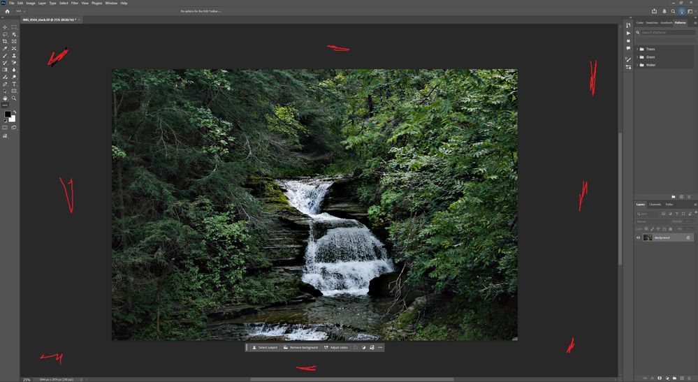

I tend to use Lightroom much more, it is not because I think it is better, it is because all the controls on photoshop are so small that I simply can't see them. I have to lean all the way forward and get my face almost to my screen to see anything on it, Lightroom appears much larger by a long shot and I can use it.
I wish there was a way to make PS bigger, I have looked it up online and had not luck. I also use Luminar Neo and find it much easier to see as well, though it is not nearly as capable as Lightroom. (I am not using Lightroom Classic)

I know part of it is my fault, I have had 5 surgeries on my eyes and now I have Glaucoma and it is having an affect, I was supposed to have my eyes checked by a specialist on August 4th but wound up in the hospital for two and half months starting on July 28th so I never made it, it has been rescheduled.  This area that is in orange should be filled with the picture, it is wasted space that would make it easier to see and the lettering for the tools needs to be easier to see.

You can click the Panel Options menu (three little bars at the top of the Panels) to increase the thumbnail size. For a larger overall interface, go to Photoshop > Preferences > UI Scaling and choose a larger font size, too. You have to restart Photoshop for it to work.
Plus you can set high contrast mode in Windows.
As to the empty space around your image that is limited by the ratio of your image and the size of your monitor. Some measurements just will not work but in Photoshop you can always select Fit on Screen in the View drop down.
I, too, have a problem seeing tiny stuff so I got as big of a monitor as my desk would allow to fit. It is a 34". I also write music and if you want to talk tiny, music gets pretty small when you have a full concert band or orchestra score on screen.
Bottom line there are ways to make PS easier to see but keep in mind any app that is as capable and through as PS is going to be tiny in places because of all the content.
