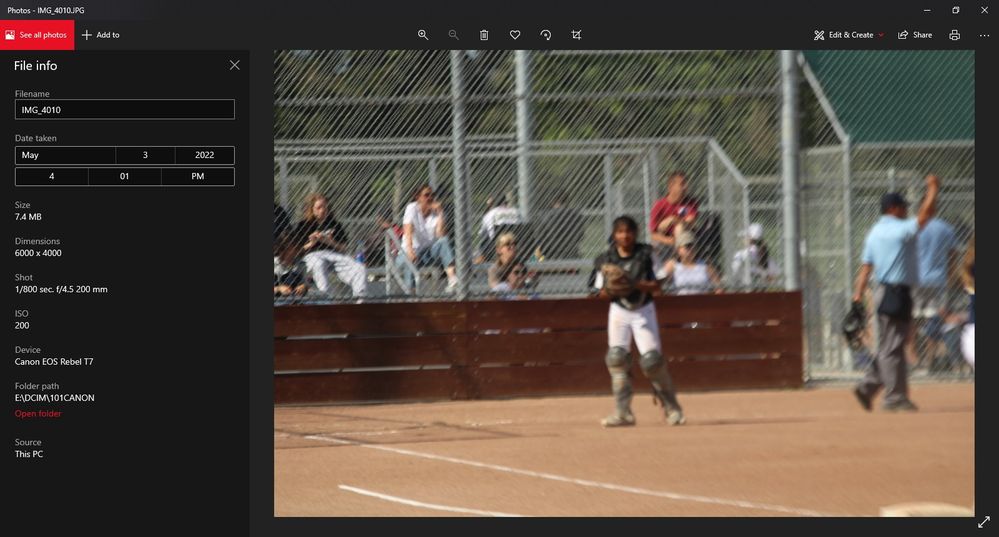

I've had the opportunity to do exactly that today. I've attached a picture from each lens, definitely thinking there's a lens issue. Used pretty close to the exact same settings. AF was one and does go through the motions of focusing, I can also attempt to MF but still doesn't come out clear. It is set to One Shot AF. When I switched lenses, I noticed how much more clear it is looking through the viewfinder on my old 300mm lens vs the 200mm lens (which is also old, bought used). 200mm lens.jpg300mm lens.jpg
Hi. Definitely see what you are talking about.
One more thing to suggest. Try using Live View via the rear LCD.
If the lens focuses properly in that mode Canon can adjust it.
Another possibility is the lens itself is defective. Do you know someone else with a Canon camera you could try? There are usually a bunch of Canon shooters at kids sports events.
If the problem still exists can you return the lens?
