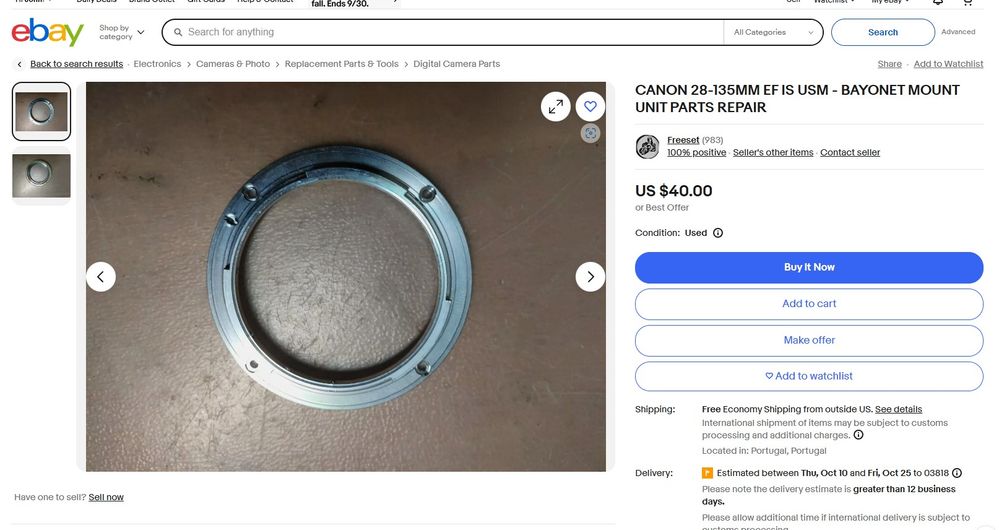

I think I identified the issue -- I think there is slight damage to the lens mount. A little bit of the metal is slightly bent in one area. I was lining up the dots and it was not working. However, this would explain that!
