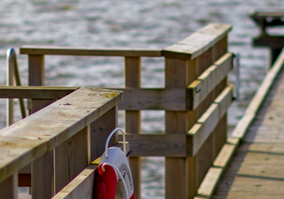

I recently purchased a Canon EF 50mm f/1.2 L USM lens and have been noticing a significant amount of chromatic aberration in my photos. This occurs even in well-lit conditions and is particularly evident around high-contrast edges.
I am attaching a raw, unedited snapshot that I took with this lens to illustrate the issue. I would greatly appreciate it if anyone could take a look and let me know if this level of chromatic aberration is normal for this lens model, or if it is possible that my lens is defective.

Ken Rockwell says there is some, but this seems excessive.
https://www.kenrockwell.com/canon/lenses/50mm-f12-continued.htm
07-03-2024 04:08 PM - edited 07-03-2024 04:12 PM
What camera body?
Are you using any filters?
Can it be removed by applying lens correction?
Has the posted image been cropped from its original size?
07-03-2024 04:10 PM
Agree with kvbarkley. The CA on the edge of the sleeve and tie does seem excessive. Have you run the image through DPP? Do you have a lens profile downloaded?
07-03-2024 04:15 PM - edited 07-03-2024 04:17 PM
“ I am attaching a raw, unedited snapshot that I took with this lens to illustrate the issue. “
The posted image seems to have been edited or modified in some way. It doesn’t contain EXIF data and it has a resolution of 999 x 771 pixels

However the fix is simple with Photoshop. But you sample has more issues than just CA.

Looks like my EF 50/1.2L USM. Axial chromatic aberration. Worst at f/1.2.
07-04-2024 03:35 AM
Camera is a Canon EOS R5.
No filters used.
I try to remove it in LrC with Lens Correction Color, but that's a pain and often creates lots of artefacts by removing magenta/orange/green color in places I don't want to be removed.
Yes, the image I posted is just a screenshot of a portion of the photo in 100% zoom. I just wanted to illustrate the issue. I just wanted to know if this much CA is normal for a Pro lens like the 50mm f/1.2 L USM.
