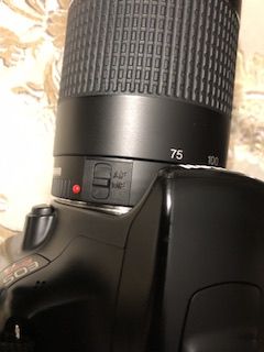

Hi I have A canon rebel T3 with 75 to 300mm f/4 5.6 lens. I currently have it to 300mm . How do I get it to Focus? Because when I look in the eye piece it’s blurry

Will the focus at other focal lengths. What happens with the lens set to manual focus. The focus ring should turn freely in manual focus. If the focus ring is hard to turn there is something broken in the lens. All of Canon's 75-300mm lenses are NOT worth repairing. It would be best to replace the lens for the 70-300mm lens @kvbarkley suggested.

I’m Able to turn it by hand to the desired 300mm . But  it won’t focus .
Are you mixing up the Focus ring with the Zoom ring. Also are you trying to turn the focus ring while the lens AF/ MF switch set to AF. Make sure the lens is set to MF before turning the focus ring. Not all lenses support Manual Focus Override. This lens Does NOT support Manual Focus Override.

I have to set the dial to manual , and the lens to MF- @300mm it still won’t focus
AF and MF on the lens is completely different than M mode on the camera. Set the lens to AF and the lens should AF if its working correctly. If it doesn't AF outside on a sunny day. Then there might be a problem with the lens. AF can be used in any mode on the mode dial. The mode dial doesn't control AF or MF on the lens.
