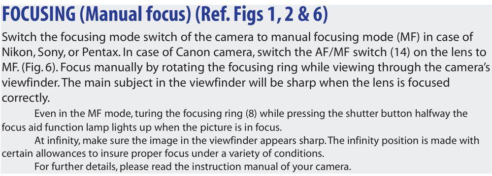

Are you having trouble getting the lens to focus at far away subjects?
I am not familiar with that particular lens, but for a few different reasons, modern AF lenses do not have a hard stop exactly at the infinity position. Most will go slightly past infinity which can result in out of focus photos. You must use AF, or carefully manually focus before the hard stop, to get in focus photos.
I am not sure which version of the Tamron 70-300 you have.
This is a quote from the manual for the Tamron  AF 70-300mm f/4-5.6 Di LD
"At infinity, make sure the image in the viewfinder appears sharp. The infinity position is made with certain allowances to insure proper focus under a variety of conditions."
This is a quote from a review on the Tamron 70-300 VC USD: "The focusing ring ends at soft stops at the close-focus and infinity focus points, and will focus past infinity."
