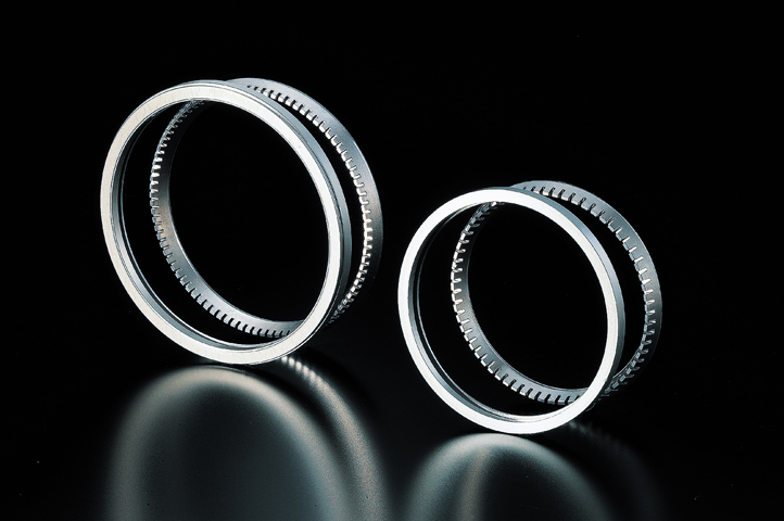

While I was trying to fix a Canon 17-85mm IS USM lens, I found out it was a USM motor failure.
I had a couple of other lens disassembly, such as 100-400mm. My feeling was the USM
motor of them are the same. I regret that I did not measure the diameter of them and other parameters...
Do anyone know if I can recycle those USM motors from other broken USM lens? Or is there a
compatible USM motor list that I can refer to?
Many thanks,
01-16-2019 11:04 AM
What I really meant was the motor ring. I understand if adding other parts then they are different.s the USM motor
01-16-2019 12:12 PM
There are two sizes of Ring Type USM motors. I believe as long as you have the same size USM motor, it should work in another lens.
01-16-2019 12:29 PM
Thank you Mike for the quick response. I guess in my case, for the normal focal distance, the small size USM motor ring are all good recycle sources that I should look for.
01-16-2019 12:54 PM
Yes, your 17-85 has the small size USM. I think the 100-400 also uses the smaller size. I think just the big Super tele's use the larger size.
Just make sure you avoid any Micro Motor or MM USM lenses, as they are not Ring Type USM, and are totally different.
01-16-2019 01:50 PM
Thanks for the confirmation. I will buy those cheap "AS IS" USM lens from ebay to fix mine. Will update this thread.
I won't confuse with those Micro motor and other small version motor 🙂
01-17-2019 10:00 AM
It is best to replace the USM as a complete assembly, once it is disassembled it can be quite tricky to get the right tension when putting it back together. The wrong tension can stop it working or make it unreliable.
01-17-2019 11:21 AM
Thank you Ray. This is a good point. I never realized this. I did the cleaning for two of my USM motor rings, I was wondering why there was wave-shaped bushing on top of the ring. So far they are still good. Since most of the broken lens (I fixed them as my hobby) are old version- of course the broken new model goes to Canon dealer - to save money while still maintaining functionality is the key...
