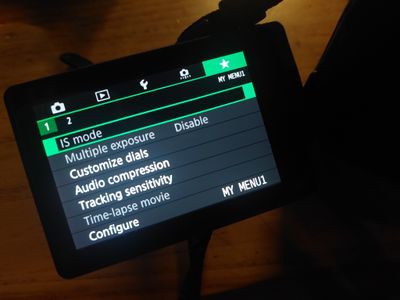

Canon RP warns "cannot be used with attached lens" in "IS mode" setting, but my lens is RF 24-105 IS STM motor. It should not give this warning.

That lens has a dedicated switch for IS. Are you also seeing an option to enable and disable it in the camera menu? That camera doesn’t have IBIS so it strictly relies on lens IS.

The Stabilizer on the lens is active. But for "Lens Mode" and "Multiple exposure" in the menu it gives "Not available with the attached lens" error.
That lens doesn’t support multiple exposure. Early RF lenses didn’t support much of the features found in newer RF lenses. They supported a lot of features as older EF lenses didn’t support much. IS mode will be grayed out in the camera menu. This is because the lens has a physical switch to turn it on or off. Therefore the menu option for it is NOT applicable in this case.
