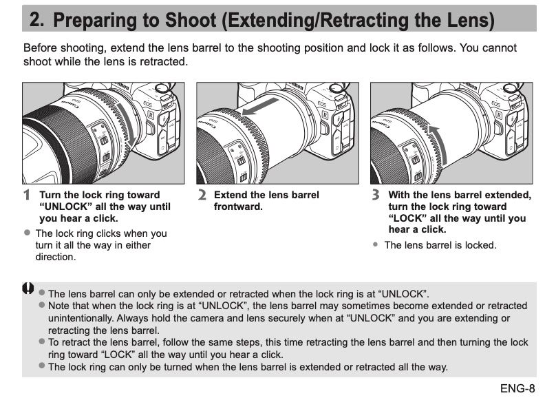

03-13-2024 11:50 PM
"There's no clue in the skimpy printed instructions that came with it,"
You sure?
03-14-2024 10:05 AM
Nope, kvbarkley. The instructions or manual page you show above was NOT included as hardcopy with my lens. All I got was a generic sheet describing the operation and features of all lenses. I have searched the Canon site in vain for a specific PDF user manual for this lens. In fact, I cannot find the lens itself as a current product. I've no doubt it's up there, somewhere, but so far I can only find the user manual on third-party websites, together with descriptions of and solutions to my exact issue. I should have done a broader search to start with instead of going straight to Canon.
