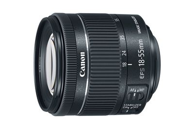

Hello,
I have a camera eos 1300d series in which i have a small lense,
Actually the problem with my camera lense (18-55) is that
By mistake the lense was droppen by me and now the AF is not working and i dont know what to do with it
Should i get it repair or buy a new one.
Consult me something informative for this issue i'm worried.

If you are talking about the lens that came in the box with the camera kit, then buy a new one.  The lens in that camera kit is an older design, with a low resale value.  You can buy a used one for a fraction of the cost of a repair.

Replace it. It isn't a repair candidate.

The EOS 1300D is an entry level, budget friendly camera.
It is often bundled with either the EF-S 18-55mm III (a non Image Stabilizer lens) or the EF-S 18-55mm IS II. Both are older lenses so it would be an upgrade to get a newer EF-S 18-55mm IS STM lens.
I would imagine you want to spend as little money as possible so buying a used  EF-S 18-55mm IS STM for about $100 might be your best option.
If you prefer to buy new, Canon sells them for $249:  EF-S 18–55mm f/4–5.6 IS STM

Agree with others that repair is not worth it. One thing to try before you discard - was the lens extended when dropped? Sometimes the extended part gets cocked in the lens barrel. If you look at lens is the part that extends crooked to one side? if so, sometimes you can push in opposite direction and snap it back into place.

Try this:
Take the lens off of your camera.
Put the lens in MF mode.
Twist the FOCUS ring (the tip of the lens) all the way to one side (extend it). You may hear a click noise or two, this is good, but don't FORCE the lens.
Twist the FOCUS ring all the way to the opposite side (retract it). Again, you may hear a couple of clicking noises. What we hope is happening is the focusing motor being put back into its proper place.
Put the lens back on the camera.
Put the lens in AF mode.
Turn the camera on.
Put the camera in AUTO or P mode.
Take a test photo.
In your case it probably won't work but try it anyway. You never know!
