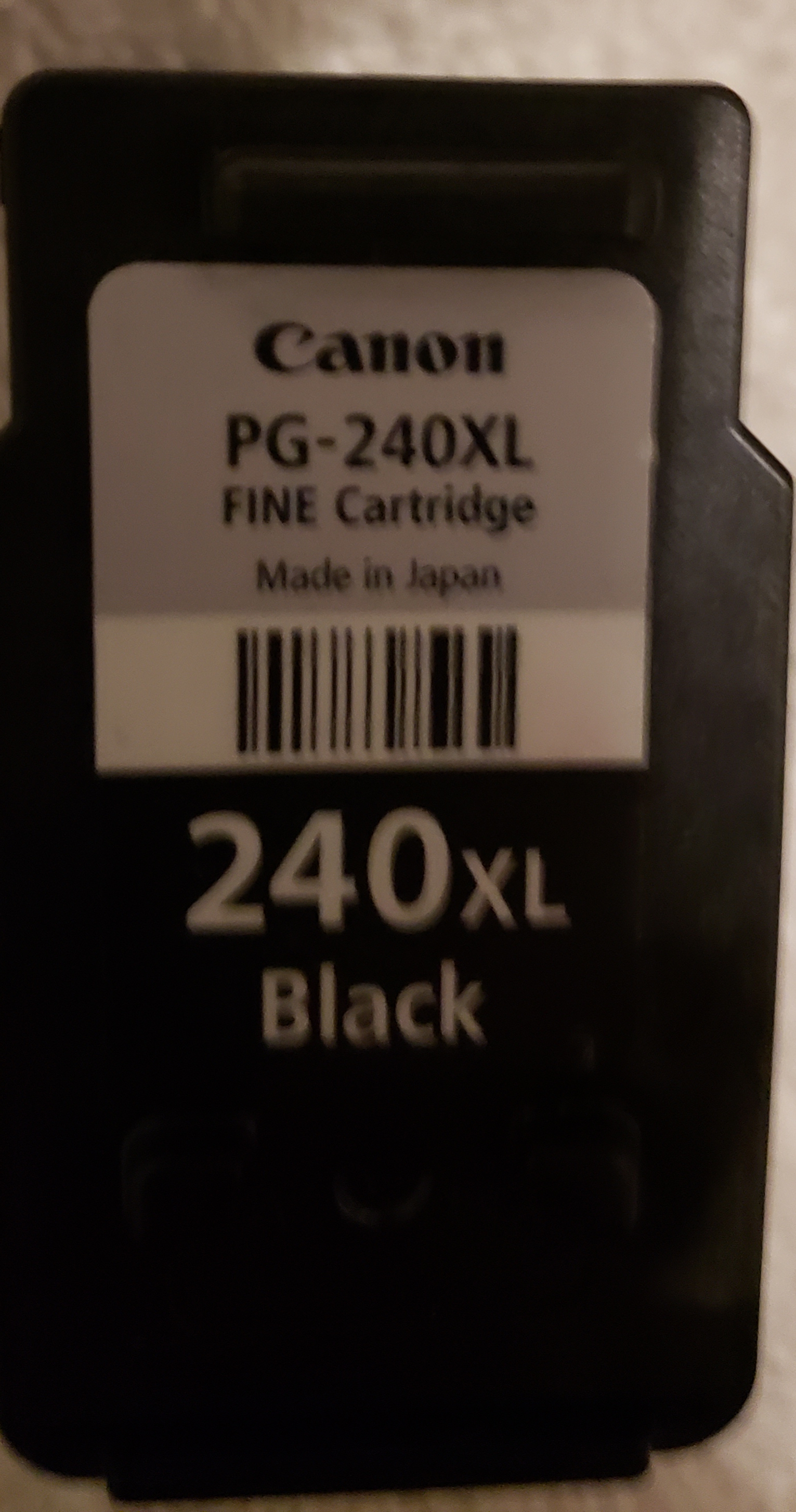

No ink on the paper may be caused by clogged nozzles.  Please click HERE and follow the steps to clean the nozzles then print the nozzle check pattern.  If the nozzle check pattern looks as it should then the trouble may be with the original file, program used to print or print settings selected.
Please attach a picture of the nozzle check pattern and the labels from the ink tanks installed in the printer with your response if cleaning the nozzles does not help.
Does this help resolve the issue described?  If so, please click the Accept as Solution button so that others may find the answer as well.
ninamarie56
I have done this a few times nothing. No ink no nothing. I can't find anything that says how to take the printer heads out and physically clean them. No this else is working at all. Help.
Hi ninamarie56.
The print head is built into the ink cartridges for this model printer. Please attach a picture of the nozzle check pattern and the labels from the ink tanks installed in the printer and attach it to your next reply.
We look forward to hearing back from you.
I wish I could nothing shows up it prints but the page is blank. It worked great but I was gone for 6 weeks and now nothing. Pics enclosed. What should I do?20190110_202638.jpg20190110_202536.jpg20190110_202657.jpg20190110_202920.jpg20190110_202948.jpg
