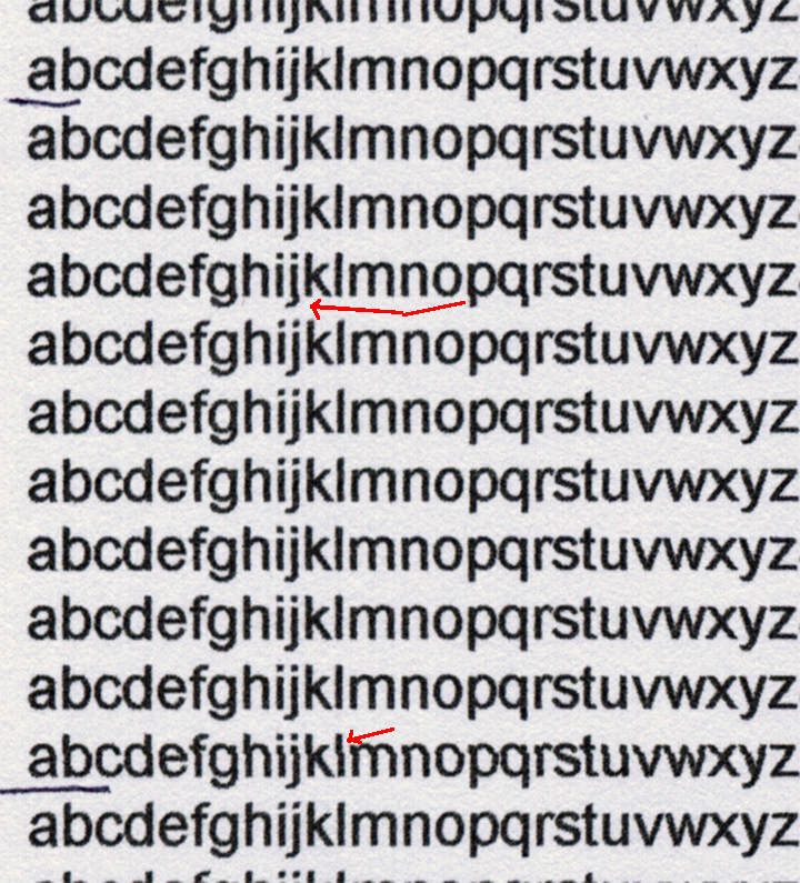

Thank you for your reply. I did both the 'automatic' and the manual print head alignment. The results are much improved. I still see problems which I have marked with red arrows in the image below.
Should I repeat the manual alignment multiple times, or are repeated tries pointless?
Help me understand. I know the printer is fast. Does the print head print multiple lines at a time or is each line of text composed of multiple passes? Is there perhaps not a correlation between 'lines of text' and print head passes on the page? Are the discontinuities I marked created by separate passes where there is a slight print head alignment error?

Today I finally found time to run through the alignment properly. My alphabet test printed cleanly with the printer properties set to 'normal' but showed the abnormalities I described above when I selected "Fast (Speed Priority) in the properties (upper right corner of the Print menu.) Should I anticipate encountering this tradeoff if and when I elect speed (and ink savings) over quality?
