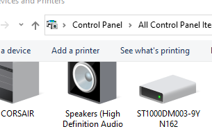

Now open Settings > Control Panel > Device and Printers
Find the printer and right-click on it , select remove device
Now use the "Add a Printer" button above

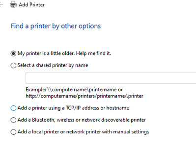

Now select the printer I want is not listed
Now select add a printer using TCP/IP address or hostname. press next

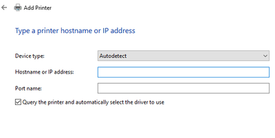

Enter the IP of the printer (Hostname or IP field) , the one you set / confirmed on the router
Press next. The printer will be detected and installed. If it doesn't detect, then the IP you specified is not correct, its not connected to your wireless. Other possibility is 3rd party anti-virus software which might block communication (if applicable).
