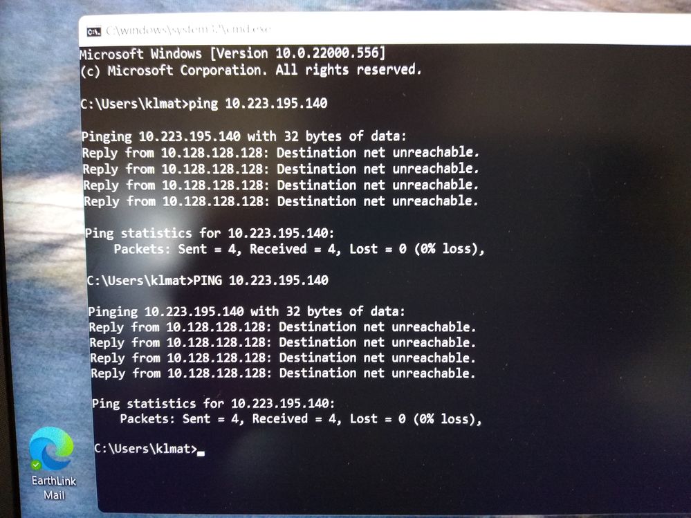

04-08-2022 06:23 PM
Hey there Patrick,
I got the computer to ping the IPv4 settings and got letter B as a result as you can see the results having run it x2,
I verified the SSID and everything matches... However, am still unable to connect. This being the case where do I go from here?
Many thanks and please reply soon.
04-13-2022 02:08 PM
Hi borgtrekker25,
Please turn your PIXMA MX922 off.
Next, please disconnect the power cord to your router for 30 seconds. After that time, please reconnect the power cord to your router.
When your router is back online, please turn your PIXMA MX922 back on.
Once on, please follow the steps in my previous post to determine if the IP address of your MX922 has changed. When you have taken note of the current IP address of your PIXMA MX922, please perform the PING command again. The Destination Host Unreachable should no longer occur.
If you get Sent 4 and Received 4, please attempt to install.
