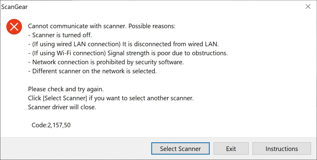

To tell the truth, I remember similar problem (2,157, 50), see the OLD screenshot. I obtained it when my printer was connected to another device (laptop) via Wi-Fi, but then I reconnected to Desktop via USB and the problem dissapered. Wi-Fi signal is not very strong, 70% usually (measured by the printer itself).
