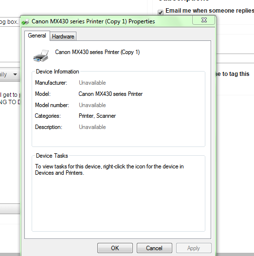

Help please, this does not work for me and I am tired of getting that message. I have followed your instructions to the letter, however, I do not have "ports as an option in properties. I do not have it in advanced properties only the drivers. What you are showing I do not have!
I am using a Canon Pixma 430 series
Windows 7 Home Pro

To everyone else who, like me, was unable to enable bidirectional support, two things.
1. Make sure that when you right click, you're then clicking PRINTER properties, not just PROPERTIES. If you click the right one, you WILL see a PORTS tab.
2. When I did that, my option to enable bidirectional support was grayed (ghosted), which left me scratching my head. But then I figured out why the computer was locking me out. By first clicking on the button circled (which grants administrator rights and allows you to change settings), I was able to finally enable bidirectional support.
If you've been frustrated by getting the error message, then seeing the option grayed out, click on Change Properties first!
