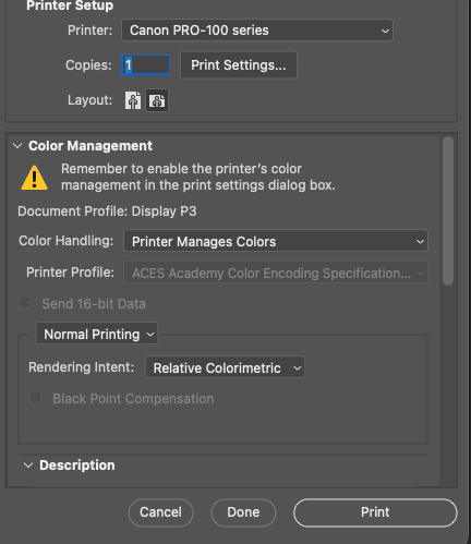

I've used this printer for over 8 years with a Dell computer but now I recently moved to a Macbook Pro. With AI help getting set up on the Mac I was initially able to get correct colors to print on the Pro-100. Then this behavior changed and the colors are a bit off. I'm using PhotoShop to print the photos.
I attached screenshots of the two views I encounter when doing this. Should I have PS manage the colors? I downloaded the Pro-100 printer drivers and can see the ink levels but there are other controls I remember with Windows that I'm not seeing here like the type of Canon paper I'm using or independently altering intensity of different colors.

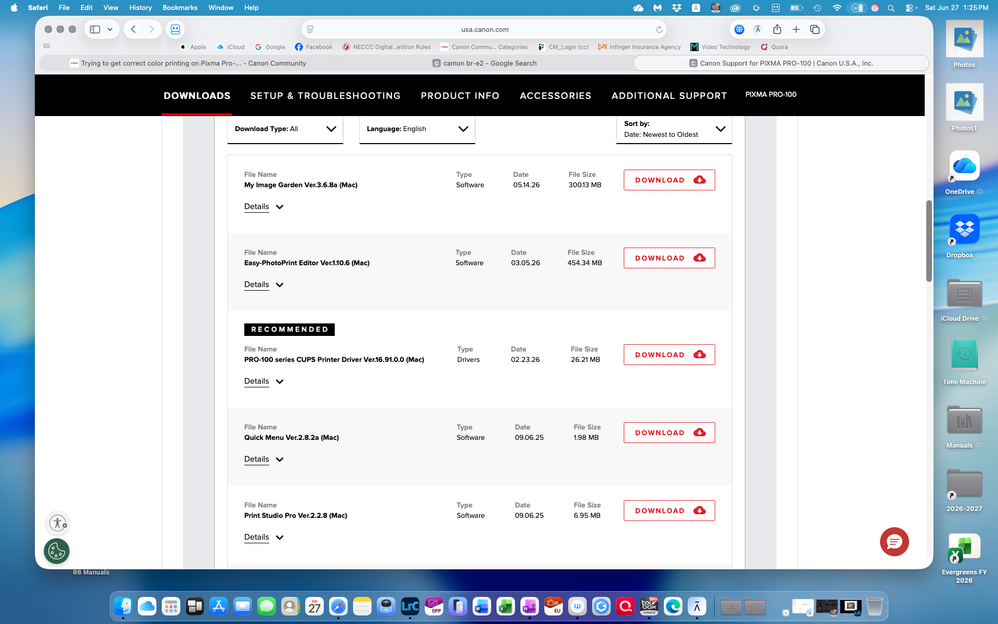

The screenshot shows that you are using the AirPrint driver. It is an Apple driver with limited capability.
You need to go to the support page for the printer and download the Canon printer driver (labeled Recommended):
After you download it double-click to install.
When installed go to System Settings->Printers & Scanners.
Select Add printers and wait for the Canon IJ Series driver to appear; could take several minutes.
Select that one and after that is set up delete the AirPrint version of the printer.
That should resolve your issue. If not come back.

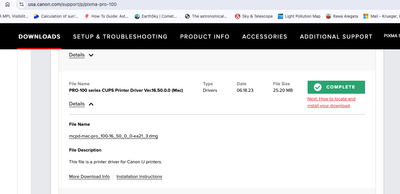

 I went to Pro-100 printer downloads page but did not find the same file you pointed out. I realized this after I downloaded the file in my attached screen capture, tried to install it, got as far as entering my password to allow installation and then it replied the installation failed and I should contact the software providers.
Your file seems to be more recent. Can you give the exact URL where I can find it? It did not show up when I searched for Pro-100 drivers. I sure didn't expect to run into this.
I just found out why the installation failed. The search page I was on had an extra query to select the correct Mac OS. With the previous post the default was set to the wrong one. Once I selected the correct one it brought up the file you pointed out. I successively installed and removed the air print driver but when I go back to PS and check Print Settings > Printer Info it still shows the Air Print driver even though I deleted it. In System Settings it shows the correct diver version I just installed. So what's happening here? I've noticed Mac seems pretty quirky with like this almost like it thinks it knows better than you.
I don’t use Ps. I use LrC. Maybe try quitting Ps and restart your Mac.
I will go and run Ps and se if I can figure out what is happening.
John Hoffman
Conway, NH
OK rebooting the Mac did the trick. I have to get used to the Mac as they sure handle differently than Windows.
