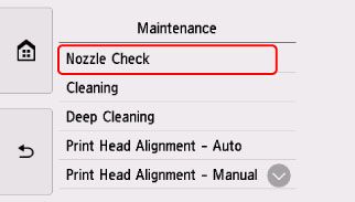

Please make sure that all of the inks contain ink and then follow these steps:
1. Please tap the gear icon at the bottom of your TS8320's display.
2. Tap Maintenance.
3. Tap Nozzle check and then Yes.
