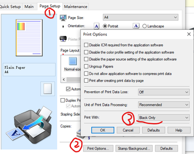

You can set: black only
Or repair the printer
11-16-2023 10:54 PM
It printed perfect.
11-16-2023 11:22 PM
Just on a whim, I did a print with color only and it printed perfect.
11-16-2023 11:34 PM
The main reason is still the inaccurate color matching of black and color.
So, both black and color only can solve this problem.
This is a very strange problem, I have never encountered such a serious color mismatch before.
