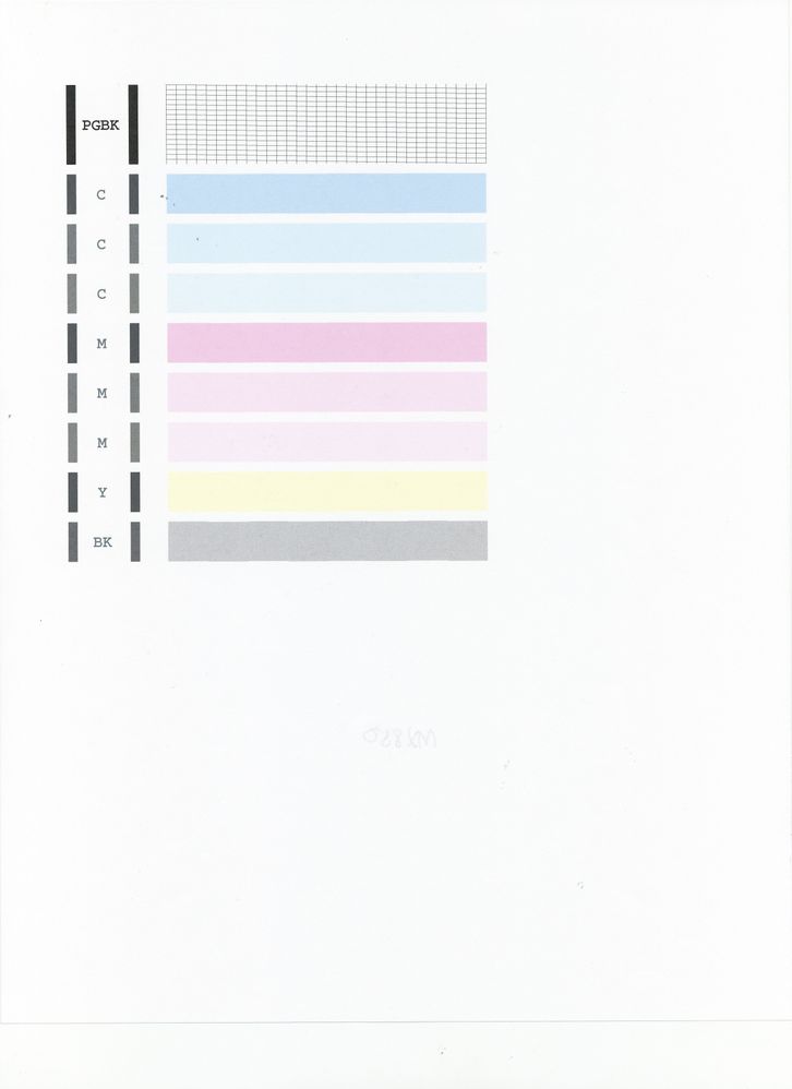

Hi kiddee,
Please print another nozzle check and compare it to the example below:
Does the black grid to the right of |PGBK| print at the top of the page that you printed?
