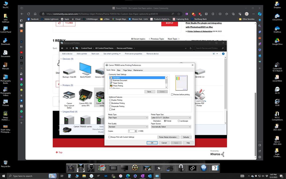

Does your driver look something like ythis?
Seelct "Standard" and see if that resolves issue.

Thanks - no, I'm only getting this;

So... not sure why it is happening, but I have (kind of) figured it out.
I had plugged my printer into my pc with a usb cable, because the WiFi connection kept dropping off, and it wouldn't print.
However, if I remove the usb cable and connect to my printer via WiFi again then I do get the full options (as per your screen shot John).
Not sure why the USB cable changes the options, but hopefully my WiFi remains stable while I print on custom sized paper.
Thanks!
Double-check the exact procedure for USB connection. Sometimes the USB connection defaults to the plug&play operating system driver, which is usually dumbed-down. It works but doesn't have the vendor specific features.
