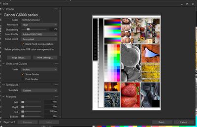

Are you letting the printer manage color or are you having the app manage color?
Can you post a screenshot of the print dialogue box?
03-24-2022 02:32 PM
Capture One Dialog
Printer Main Settings
Printer Quick Settings
Those are what I see in Capture One. I have played with the manual adjustments a little, with no noticeable effect in the output.
PhotoPrint doesn't give me access to those adjustments.
03-24-2022 02:42 PM
The settings look correct. I don't have anything more I can suggest.
