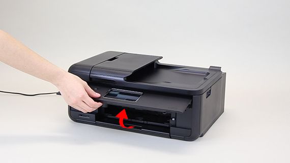

I think you need to open the operational/control panel just lift it up leave it up to print and make sure the output tray is extended.

Error Code 1240 is a specific "Action Required" state. In most cases, this isn't a mechanical failure but a sensor detecting that the printer isn't physically ready to receive a page. This happens if:
The Operation Panel is closed: The front face of the printer (where the screen is) must be tilted open/upward for the printer to function.Raise Operation Panel
The Output Tray is retracted: The tray that catches the paper must be fully extended.
If you have already confirmed both of these are open and you’ve performed a power cycle, there may be a small piece of protective packing material or a stuck sensor internally.
