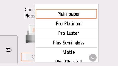

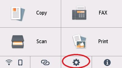

To set the rear tray to 4" x 6", please follow these steps:
1.  Tap the gear icon.
2.  Tap Feed settings.
3.  Tap Rear tray paper settings.
4.  Tap Change.
5. Select a paper size that is NOT the size you wish to print with.
 6.  Select a paper type.
7.  Tap Yes.
Once set, please attempt to print.
