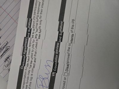

PIXMA TR4722 misaligned when printing in Landscape.
Rkbliss
I took a photo of one my printouts, and tried to look up what could be the cause. I ran a print test page, made sure there was nothing inside my printer that could be throwing it off, etc. Printing in portrait no problems. But as soon as I need to print in Landscape it's all over the place. What could possibly be the issue? I'm not very tech savvy so hopefully it isn't anything too complex. #TR4722 #misaligned #landscape #printingmisaligned

What is the misalignment? Printed lines on the page? Margins off, print not centered? Can you post an example? I am trying to determine if this is a printhead alignment issue, it is possible that the head can misalign for one mode and not another.

Good afternoon. It is now doing it in Portrait also. Also, I noticed when printing there is alot of banging or thumping noises going on from inside my printer. This poor thing has been through ALOT, it's been used alot; including moving 5 states on a truck with movers who probably weren't gentle with it. It kind of sucks because I just got new cartridges. I'm going to try to use them up.
But I did do alot of those things on that list. And I went to print my outline for my debate in class today and half the lines were missing. So it's gotta be internal.
