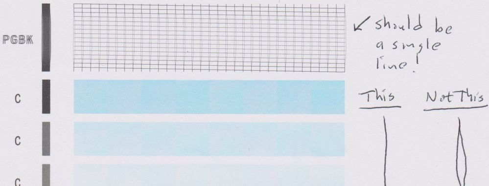

I have a Canon MX922 printer and it prints a single vertical line like a line that splits into 2 lines that gets further apart as it moves down, and then returns to join back together. I have attached a photo from the image I get when doing a head clean. I appreciate if anyone can point me in the right direction. I think I've tried everything. Thanks

Hi,
You can try cleaning the encoder strip inside the printer. Please click HERE for the steps.
If this does not resolve the issue and the printer is in it's 1 year warranty, I recommend reaching out to Canon support for your warranty options. You will need to register your Canon gear HERE to access additional support options.
