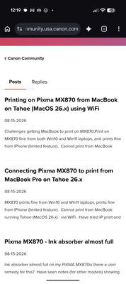

Greetings ,
You are resurrecting an 8-year-old topic, for a product that is different than your own.
You've also started multiple individual threads for your printer model.  It would be a lot easier for us to assist you if you kept all of your questions in regards to your printer in one thread.
Thanks in advance.
Here is a listing of your topics. 😉
https://community.usa.canon.com/t5/user/viewprofilepage/user-id/273227
