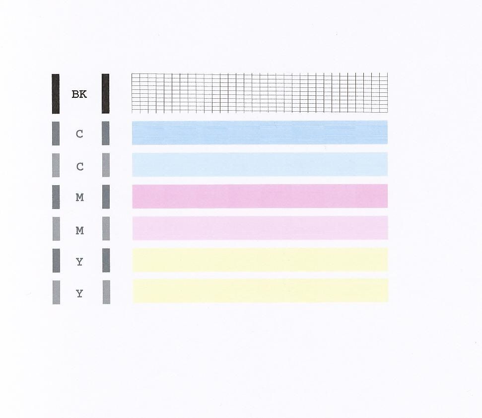

You can perform maintenance features from your printer itself, without the need for a computer.
First, please print a test page. To do this, please hold down the STOP button until the Error light blinks 1 time, then release it immediately.
Please compare your printout with the example at the bottom of this post.
If they differ, please perform a few printhead cleanings by holding down the STOP button until the Alarm lamp flashes orange twice, then release it immediately.
More information regarding maintenance procedures can be viewed in the manual by clicking this link:
