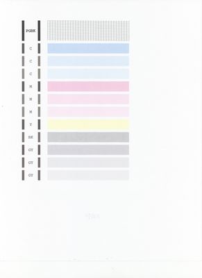

Next, a test of the printer should be performed. This will tell us if the printer is working correctly. To do this, please load letter-sized paper in the PIXMA MG7120 and follow these steps:
1. Flick the HOME screen and then tap Setup.
2. Tap Maintenance.
3. Tap Print nozzle check pattern.
4. Tap Yes.
The Nozzle Check will print. Please compare your printout to the example that has been attached to this message. If they differ, please perform a few printhead cleanings.

Thanks for the reply. Sadly that had no impact.
Does the fact that the printer lags for an extended period mean anything? I've assumed that the size of the print job is causing the issue. When I print a Word doc the printer prints immediately. When I attempt to print graphics, the job sits for at least 2 minutes before attempting to print ...
Thanks again.
